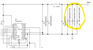

Hi

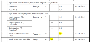

The contents below are in DATASHET P.23 of TPS2374.
When I tested the contents below, I'm not satisfied if I don't reduce the BUCK CAP(C9,C11,C41) capacity.
Can the output CAP satisfy the contents below with 300uF?
If there is a way, can you tell me how to do it

  • Hi David,
    Thanks for your patience.
    300 uF looks very high for PoE application thus during the PD inrush period. TPS2373-4 has 275 mA lowest inrush current. 57V * 300uF / 275mA = 62 ms which is longest inrush time needed.
    According to the standard, PDs shall draw less than IInrush_PD and IInrush_PD-2P from TInrush_PD max until Tdelay min, when connected to a source that meets the requirements of 145.2.10.7. In this condition. 62 ms should be an ok value.
    The recommended bulk cap value in PoE PD application is shown below:
    Power                  Bulk Cap
    13W                      10-22uF
    25W                      33-47uF
    50W                      68-100uF
    70W                      100uF-200uF
