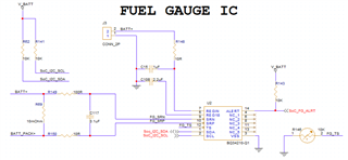

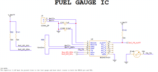

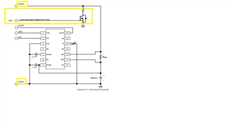

We are planning to use BQ34210IPWRQ1 to monitor a battery. So while designing, I'm a bit confused about designing SRP and SRN pins. While referring to the datasheet and EVK, it is seen that SRP and SRN are connected to a PACK+ AND PACK- through a sense resistor. and also a N-Channel mosfet is connected to it with a learning load.  So could you help me with designing SRP and SRN pins.
