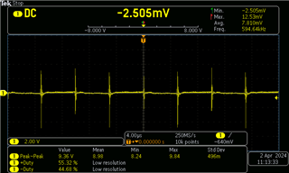

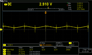

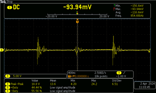

  • Hi Manikanta,
    Thanks for waiting for my reply and support...

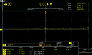

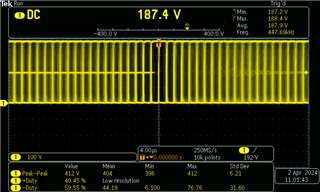

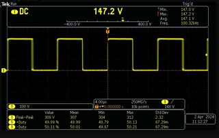

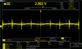

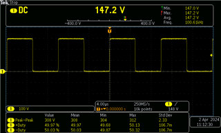

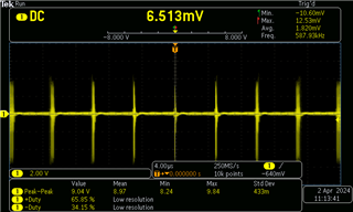

    Yes, I did the temperature measurement, but all the components are in normal range <45 degrees Celsius. Only LLC transformer will making noises once we connect the PFC and Mosfets will fail after 35 ~ 40 minutes. There is no problem when we load LLC without PFC.
    Check out the waveforms of the VCR, HS, ISNS. Due to PFC switching noise all the signals are disturbed.
    Note:
    1. Run --> Waveforms captures at DSO Run Mode.
    2. Stop -->Waveforms captures at DSO Stop mode or Single Capture waveforms captured.
    HS Run Mode with PFC ON
    HS Stop Mode (Single) with PFC ON
    HS Run Mode with PFC OFF
    HS Stop Mode (Single) with PFC OFF
    VCR RUN PFC ON
    VCR STOP (Single) PFC ON
    VCR RUN PFC OFF
    VCR STOP (Single) PFC OFF
    ISNS RUN PFC ON
    ISNS STOP (Single) PFC ON
    ISNS Stop PFC ON
    ISNS RUN PFC OFF
    ISNS STOP (Single) PFC OFF
    Please check and help me out of this issues...
