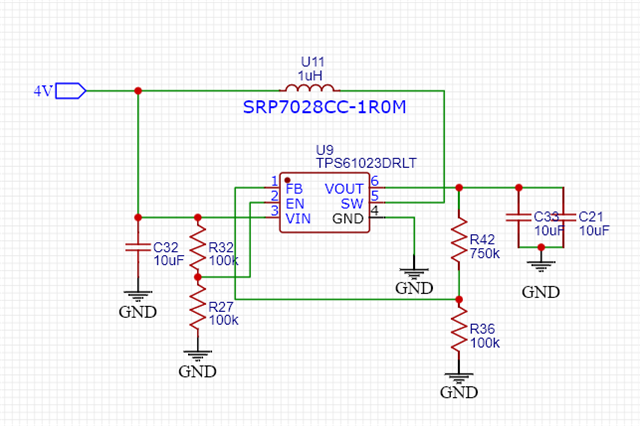

We made a following schematic.  On giving Vin = 4V using battery, Vout was 5.06V as expected. Load is very light and should be in few mA. We are just powering MCU.
Now  the Vout is at~ 1V. What could be caused ?
We didn't touch anything in schematic. All we remember we disconnect/connect  few times Vin supply coming from Lithium battery.

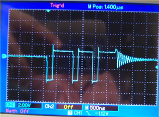

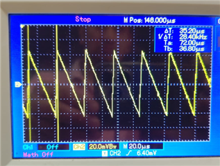

    Below are waveform at SW and Vo captured with AC coupling. Yellow one is Vout. There is ringing in SW. Please let know your comments.
  • Hi Nick,
    SW ringing is normal for switching regulators and the IC will be fine as long as your SW spike is below our maximum ratings:
    We advise measuring the SW spike under your maximum inductor current because the SW spike gets worse when heavy load is applied.
