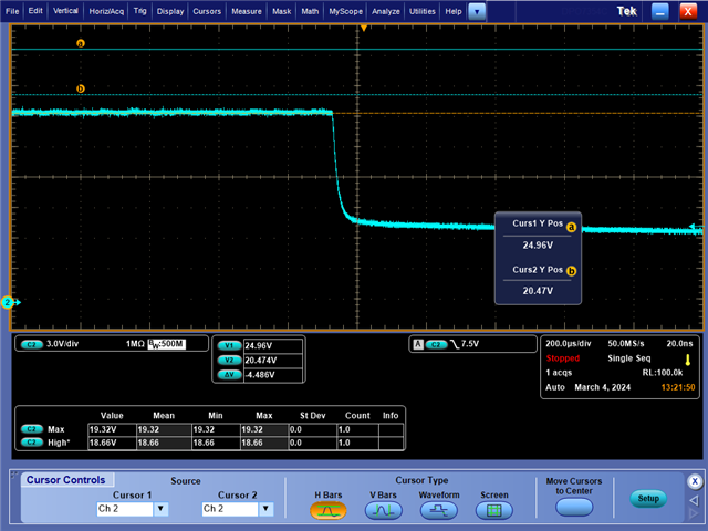

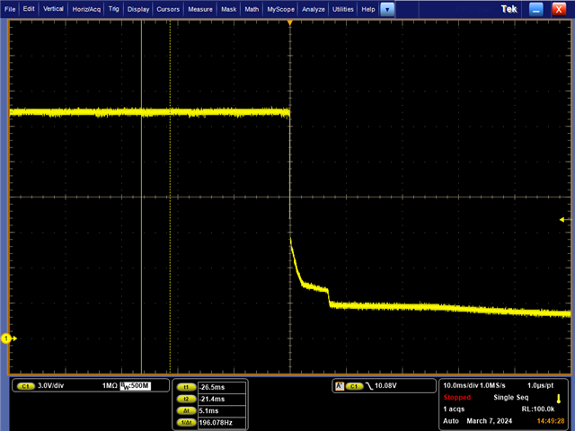

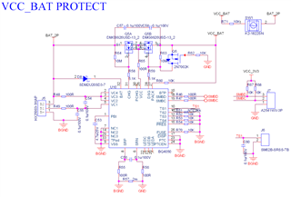

While using BQ4050 with 2 cell 18650 in series, it was found after running some time (1 hour to 6 hours), DSG and CSG will drop, that caused system to restart.
Is there any potential reason that trig the drop of DSG.CSG? While, checking Lifetimes  and Black Box, there is no logs for any event happen.
DSGCSG
Another question is: battery can not be charged once it was experienced few discharging cycles. CEDV function is not used in BQ4050.
