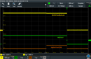

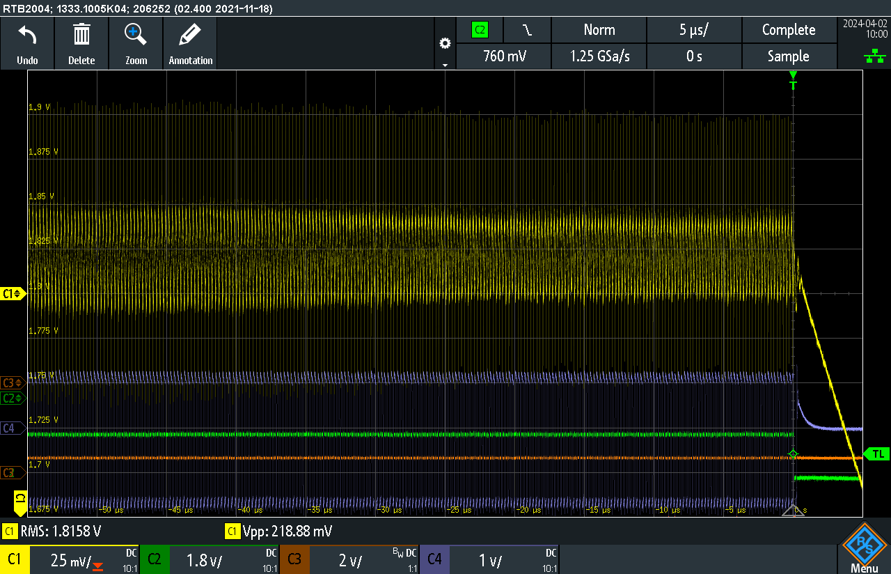

  • PMIC shuts down (nRSTOUT is deasserted) and is no longer accessible over i2c (using EVM and PMIC-GUI 3.0.0) after applying a 2A load on BUCK4.
  • PMIC seems stuck in this state and requires a power cycle to start back up.
This seems isolated to the BUCK4, loading BUCK3 in the same manner does not cause shutdown. The BUCK4 should be good for 4.5A and we fail already at 2A.
The steps to trigger the behavior is as follows:
  1. Power up board - OK
  2. Check PMIC status over I2C - OK
  3. Apply 2 A load using the external DC load - nRSTOUT is deasserted and PMIC is stuck in shutdown (see oscilloscope screen capture)
  4. Check PMIC status over I2C - TI PMIC-GUI can no longer detect the PMIC.

    Can you provide scope capture that is zoomed in on the BUCK4 FB while at 2A? Make the vertical scale for the channel 20mV/div and the horizonal scale 5us/div. On the same scope shot, please get the BUCK4 switch node at 1V/div.

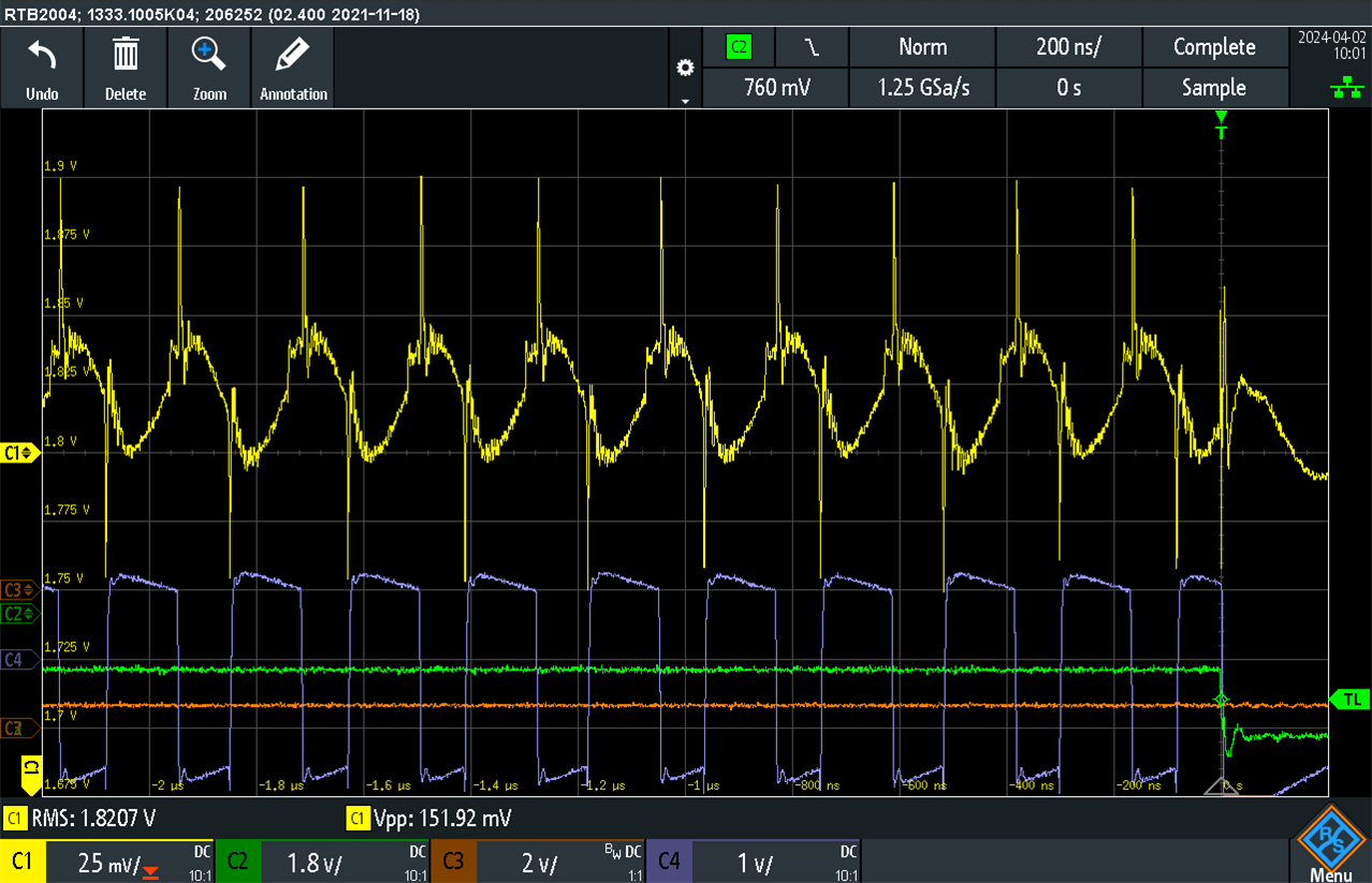

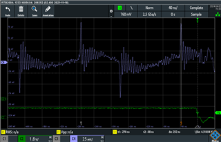

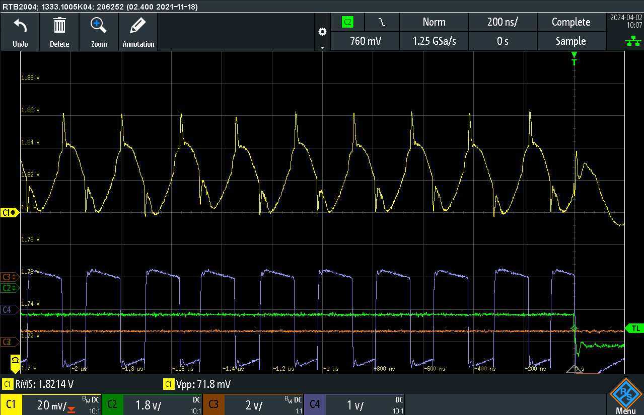

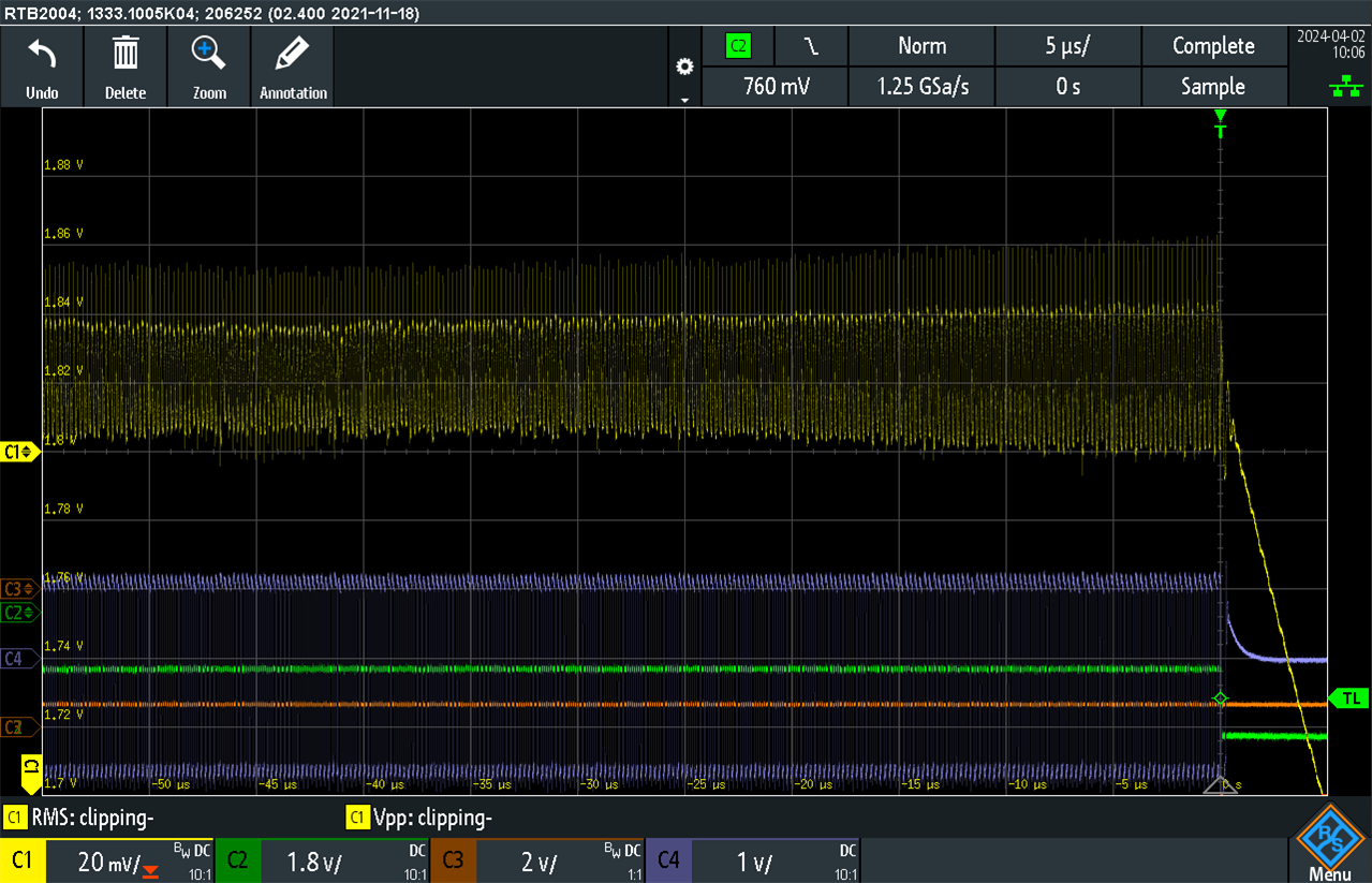

    Sure, here's a set of captures with different zoom and BW limit.
    Legend:
    Color
    Probe point
    Yellow (single-ended)
    Feedback
    Blue (diff probe)
    Switching node
    Green
    nRSTOUT
    Orange
    Load
    Full BW:
    20MHz BW on switching node.
    A scope shot of the inductor current and switch node would be helpful here.

  • Short update here before end of day.
    Tried adding 1 uF close to the VOUT_LDOVINT pin, this seems to increase the possible load to ~2.9A before shutdown. Adding yet another 1 uF (then 2uF in total + existing capacitance), increases possible load to maybe ~3.3-3.4A.
    Still same behavior though: Shutdown and i2c communications loss is permanent until power cycle.
    Additionally, we see that we have quite some ringing at the point of load seemingly caused by the high dv/dt spikes seen in the previous screen captures. Will try to improve decoupling to suppress this behavior.

  • Hello Anton,
    Thank you for al the information, it is very helpful.
    I believe the noise on BUCK4 is leaking into VOUT_LDOVINT pin and causing a digital reset to occur. Not having proper placement of the cap makes it more susceptible to noise. Hence why adding the extra capacitance helped.

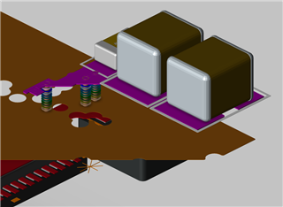

    Here's an overview of how the BUCK4 rail is distributed, dark orange colored plane is the BUCK4 output.
    The feedback is currently positioned next to the inductor, in the same node where it connects to decoupling and bulk capacitors on the other side of the board. (Feedback pin is the centermost pin, you can see the vias going though as circles in the plane)
    We have seen that the noise on the rail can be reduced to some extent by adding capacitance on the PMIC side to calm the FB node a bit, but with diminishing returns and no change in the "permanent" shutdown behavior.

  • The feedback is currently positioned next to the inductor, in the same node where it connects to decoupling and bulk capacitors on the other side of the board. (Feedback pin is the centermost pin, you can see the vias going though as circles in the plane)
    This is the source of the high noise on BUCK4 which causes problems for the LDOVINT.
    Your diagram highlights 4 POL for BUCK4. If you know that one of them will have the largest load pull, I recommend routing to that POL.
    Also a FB line should be thin and preferably shielded to prevent noise from getting in.
