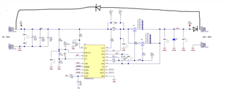

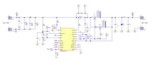

We consider working with the TPS4811-Q1 for protecting servo motors ( 48VDC)  that used in our application
For testing it we connect the TPS48110Q1EVM ( evaluation board from TI )  to one motor. see the below scheme

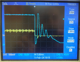

during test this circuit and validate its well action  - disconnect the load at the desired threshold 8A after 1 sec, see below curves
blue  - output voltage
yellow  - output current ( current prove 10mv/1A)
the TPS48110-Q1 damaged and stop function.
I assume due to reverse current as you can see the little negative yellow hill
is it true ? how can I protect it from reverse current ?
