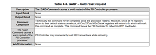

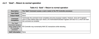

The TPS65987D will reboot its OTP bootloader when a "GAID" command is sent.

Hi Xavier,
The HRESET pin reinitializes the device settings similar to a warm reset (Gaid) so it would not reload the FW from SPI flash.
