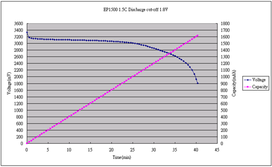

Here is a discharge profile of the cells we're using (We cutoff at 2.9V, not at 1.8V as per the graph, because the chip will shutdown at that voltage)
You will notice the extremely flat discharge voltage between 10 and 90%. We have set the default cell differential for balacing to 10mV, but I believe this is too tight.

    LIFEPO4 cell have a -very very- flat OCV curve. I believe that the cells are wrongly balanced when they are at the flattest point, caused by the little off-spec voltage offset.
