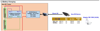

If the customer uses a 2pcs battery as a series and does not use BMS board.
I suggest customer use BQ294582+BQ25306 to design. It is okay for this?
simple blocks below.
Hi Jimmy,
This looks good. One thing to note is that the lower battery in the stack should go to the lower VC inputs.
