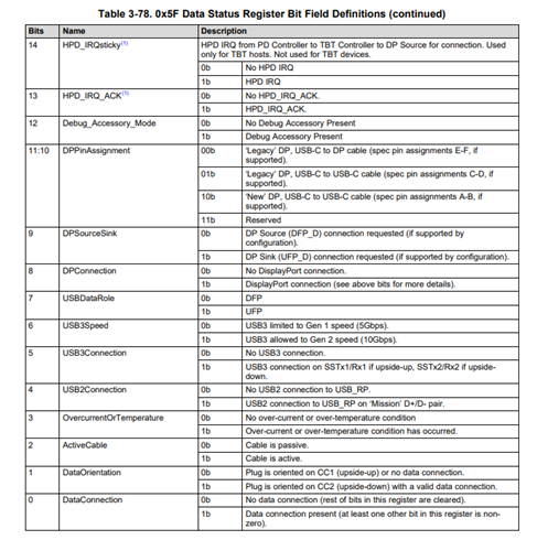

  • Hi Yamamoto,
    Do you have access to I2C1 from the PD on your board? If you do, you can try and read register 0x5F Data Status register for details on the connection made with the SSD.
    Below are my comments on the GPIO setup:
    GPIO0 - Port 0 USB3 Event should trigger on connection of the SSD but it is not in your case. This means the PD may not be recognizing the connection as a USB3 connection.
    GPIO1 - Port 0 DP Mode Select Event should not trigger on connection of the SSD because the SSD does not support DisplayPort.
    GPIO3 - This is again tied with DisplayPort, which the SSD does not support. This will remain low.
    GPIO21 - Port 0 Cable Orientation will flip with the connection orientation.
    Next step I recommend taking is to gain PD_I2C1 access from your board, so you can read some status registers. Without this information, we are unable to tell what connection is made with the SSD or what is the root cause of the low data rate.

  • Mr. Alex
    thank you for your reply.
    Reports the result of 0xF5 register.
    Not connected → 0000000000
    Type-cHub1 → 3305000000
    Type-cHub2 → 3105000000
    SSD direct connection 1 → 0300000000
    SSD direct connection 2 → 0100000000

  • Hi Yamamoto,
    From our register definition for register 0x5F, the PD does not detect any USB2 or USB3 connection at all when the SSD is attached. In order for the PD to detect the connection type and report the correct connection, the SSD must respond to the PD's Discover Identity request message. Could you please read out register 0x48 so we can see if the SSD responded?
    If you have access to a PD analyzer tool such as TotalPhase or EZ-PD, you could use that to capture the PD messaging for more information. There should not be a hardware issue since the type-C hub you used was working with the PD. There is no software driver for the USB-PD connections, if needed after we find the root cause, we can change the PD configuration.

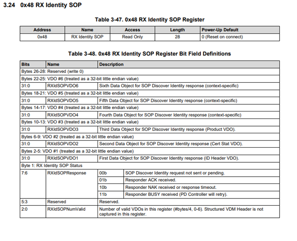

  • thank you for your reply.
    Although the confirmation is delayed, I will inform you of the result of the 0x48 register.
    SSD direct connection (byte length 28) All “00”
    →'00000000000000000000000000000000000000000000000000000000
    Type-c Hub (byte length 28)
    → 44E804006C00000000120220A0390000000000000000000000000000

  • Hi Yamamoto,
    BP_NoWait is the fastest boot mode from a dead battery scenario. Dead battery is when PD boots from the type-C port without system power. In a normal scenario when PD/system is already powered at connection of the type-C device, dead battery mode does not apply.
    From the result of the register 0x48 read, it looks like the PD did not send Discover Identity message to the far-end connected SSD. Combined with the result of the register 0x5F read you did before, it looks like the SSD is type-C only, so we would not do the same discover identity sequence that we do for PD. That being said, there should still be a USB3 type-C connection.

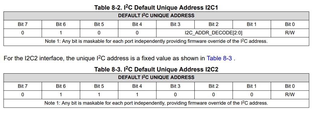

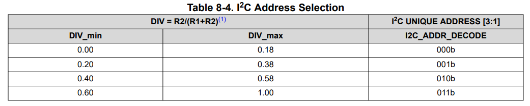

    Since your system does not boot from the type-C port in dead battery condition, you do not need to worry about the ADCIN dead battery configurations. The ADCIN2 pins will only be used to set the I2C address like below. The ADCIN1 pin is a "don't care" from the PD point of view unless booting with no system power.

    (3).0x5F (Data Status) register read result
    The first byte changed from “0” to “3”.
    SSD direct connection 1: 0300000000 → 3300000000
    SSD direct connection 2: 0100000000 → 3100000000
