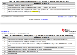

      We have built a BMS system using bq79616 and bq79600, now we can set up the device address in both communication directions, but  then we can't change the communication direction.
Here is my code:
.WriteReg(0, CONTROL1, 0x0+0x80, 1, FRMWRT_SGL_W); //反向编地址
WriteReg(0, COMM_CTRL, 0x00, 1, FRMWRT_SGL_W);
WriteReg(0, CONTROL1, 0x80, BoardNum-1, FRMWRT_REV_ALL_W);
  • WriteReg(0, CONTROL1, 0x0+0x80, 1, FRMWRT_SGL_W);
    WriteReg(BoardNum-1, COMM_CTRL, 0x03, 1, FRMWRT_SGL_W);
  • The above code is not working properly

    Have you auto addressed and communicated with the device before executing this code?
     Please review the auto-address directions in the BQ79600 datasheet to make sure you are auto-addressing properly before changing the communication direction.
    Additionally try read the COMM_CTRL register and make sure the BQ79616 is configured properly. The BQ79600 should automatically be configured as the base device with an address of 0x00.
    You must have a daisy chain cable between COMH of base to COML of Stack1 and a daisy chain cable between COML of base to COMH of Stack1. To communicate in the south direction, set DIR_SEL = 1. To communicate in the north direction, set DIR_SEL = 0.
