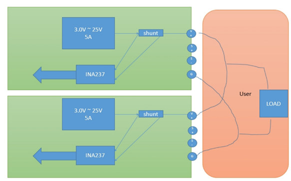

Hi Sir
I want to design a power stage as below, output need 3~25v/5A, Outputs can be connected in parallel
the LM5149 is the right solution for this application?
thanks

Hello Alex,
It possible to use the LM5149 for parallel output. but for 5A it is likely not necessary to use a dual phase interleaved approach. Hope this helps.

Hello Alex,
suggest using single phase only, no need for dual phase interleaved. hope this helps,

hi David
We need to design a Adjustable Dc source,
spec vin :48v, vout :5v~25v(5A) ,ripple 1%
LM5149 can did it?
thanks
Hello Alex,
please refer to the application note, link below for adjusting output voltage.
Hope this helps,
Methods of output-voltage adjustment for DC/DC converters (ti.com)
