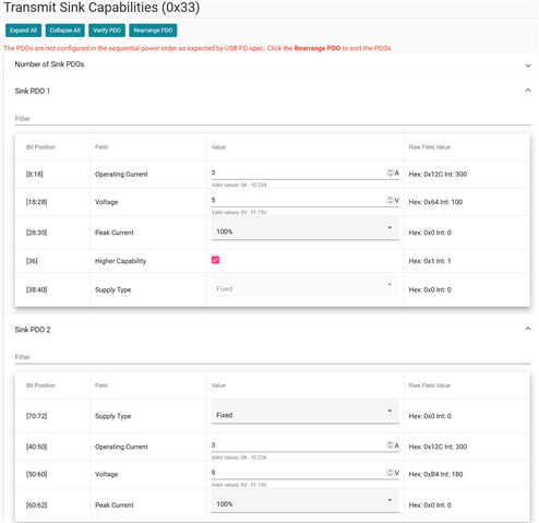

  • Hi again,
    I PDOs setting still not wrote.
    Looking for more information on the forum, I found some thread speaking about PDO settings.
    I discover that the software tool can also make presetting of these PDOs with advanced menu however, I have an error message include with default setting.
    In which order PDOs must be set? Increasing or decreasing? I don't reach to find info on the web.
    Any help will be welcome.

  • Hi Conner,
    Yes it help. I mainly have to learn USB PD concept before for better understand how to use the chips. For example, where use fixed or variable voltage PDOs.
    In fact, I was reading "RX_SINK" and "RX_SOURCE" for check "TX_SINK" and "TX_SOURCE". "RX" are for read PDOs from connected device.
    So, reading the good ("TX") register I detect an error loading the PDOs data. I fix it and now is working and reach 20V as expected.
    Also, I am able to read the contract result and so, can manage the charge current depending of power supply capability.
    Still to try source mode but I am not afraid because it should work.
    To resume, I think that in the datasheet  was missing an small introduction  showing a basic USB PD transaction concept and also a small picture to explain quickly that the TPS need a code load using the web tool (where I detect some bugs to fix).
