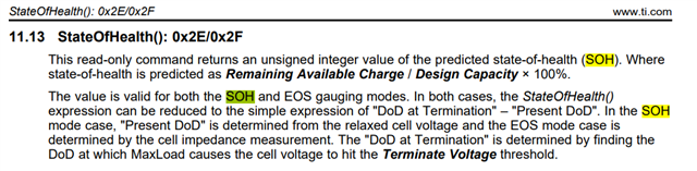

  • Hi Arun Babu S,
    The formula you showed is a high-level formula so you will not be able to plug numbers in to calculate the exact number. However, AccumlatedCapacity is Accumulated Passed Charge.
    SOH will report a battery percentage.
