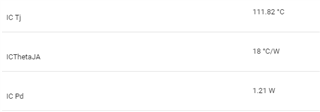

I'm trying to build a 48Vin-15Vout-2AIout buck converter using LM5012. As the ambient temperature is 90 degree, we should be careful not to exceed Tjmax.
Thus, I took advantage of WEBENCH to calculate the loss, efficiency and Tjmax.
webench.ti.com/.../SDP.cgi
However, some questions come to my mind. Then, Could you answer the following questions?
1. Why is the ICThetaJA 18 degree/W in WEBENCH? In the datasheet of LM5012, both ThetaJA in EVM(29degree/W) and ThetaJA in JEDEC PCB(34.8degree/W)) are above 18 degree/W. Where does this value come from?
2. Can we change the ICThetaJA in WEBENCH to calculate IC Tj appropriately?

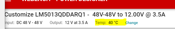

3. As you know, a loss from converter increases with increasing temperature, and I found IC Pd in WEBENCH can consider this effect.
Which temperature is considered in the estimation of IC Pd? Ambient temperature or IC Tj in the operating condition?
