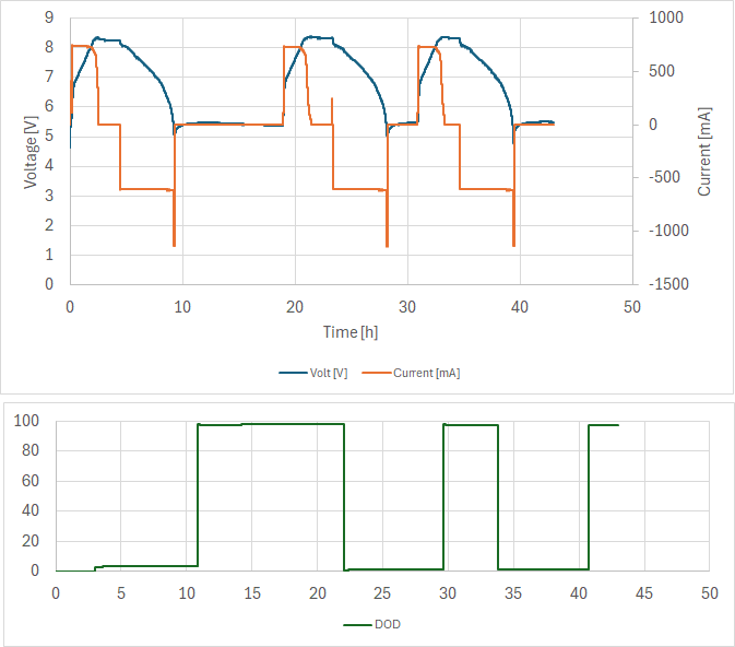

Hi, team
update state is successfully updated from 04->05 but not from 05->06.
I am attaching the log file.
Charging and discharging has been repeated for 3 cycles but did not give the desired result.
'OCVTAKEN' changed to High and the charging and discharging process proceeded. I verified that the 'QEN' bit was High at all steps.
Could you give me some advice ?
- Board BQ34Z100EVM
- Chemistry ID 2085
- 2 cells, seriesed
Best regards
