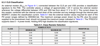

    Q1.
    Can TPS23731 be set for IEEE 802.3af class2 or class 3?
    Q2.
    If Q1 answer is yes, could you please tell me how to set?
    Thank you again and best regards,
    Kazuya.
  • Hi Kazuya,
    Q1: Yes it can! All IEEE802.3bt devices are backwards compliant. Therefore, TPS23731 can be Type 1 or Type 2 as well.
    Q2: The class level is controlled by an external classification resistor which is measured by the PSE and the current sank during classification.
    Brandon

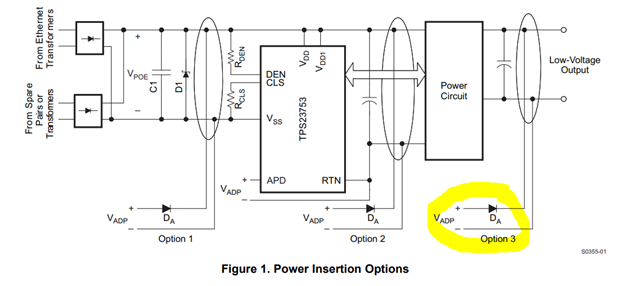

  • Hi Brandon,
    Thank you very much for your reply.
    The APP note you attached is very helpful for the customer and me.
    Could I ask you a question about the APP note?
    Q.
    3.3 I think option 2 in the APP note would be the best to implement the function for DC adapter prioritization.
    But I couldn't find the pin of TPS23755 which has same function as the APD pin of TPS23753.
    Can this option 2 not be applied to TPS23755?
    Kazuya.
  • Hi Kazuya,
    TPS23755 has secondary side adapter input, not primary side adapter input. Therefore, if you wish to use OR'ing option 2 I would recommend TPS23758 which has primary side OR'ing functionality. Note, when using TPS23758 you will need secondary side sync-FET.
    Brandon

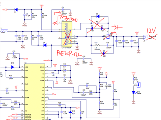

  • Hello Diang,
    The reply is very helpful for the customer and me.
    I attached excel file for confirming which point must be modified.
    Could you please take a look and check it if it is correct?
    And if you find any wrong point, could you please tell me it?
    Also please tell me D1a and D2a spec?
    Kazuya.
    AttchedFile041724a.xlsx

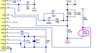

  • Hi Kazuya,
    Thanks for your patience!
    Recommend to increase R26 from 9.09k to ~13k. Threshold of APD is ~1.5 V so a 30V adapter needs a higher resistor divider ratio. Other parts look good to me.
    Diang
  • Hi Diang,
    Thank you very much for your checking.
    I understood. I will tell the customer to change R26 to ~13kohm.

    Could I ask you the following questions?
    Q.
    This EVM output voltage is 5V. My customer requirement is 12V output.
    I think T1 and R18 are needed to be changed for output voltage changing at least.
    Is my thought correct?
    Do you have any recommended transformer for T1 and resistor value for R18?
    Also do they need to change any other parts for 12V output?
    Kazuya.
  • Hi Diang,
    I found the following transformer for 12V output with TPS23756.
    Coilcraft JA4667-AL_
    https://www.coilcraft.com/getmedia/74b6c458-1e13-4e3f-86de-075ba4a9171a/ja4249.pdf
    Can this transformer be used?
    Thank you very much and best regards,
    Kazuya.
  • Hi Kazuya,
    Thanks  for your reply.
    JA4667-AL_ looks like the correct part for 12-V output design.
    For the feedback resistors, you can refer TPS23754EVM (https://www.ti.com/tool/TPS23754EVM-383) values, which is a 12-V rated forward converter circuit.
    Diang
