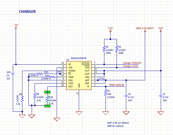

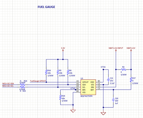

    I have attached our circuit for your reference (R4 and R11 are not populated in the circuit). Please check the circuit and give us solution.
    Aslam
