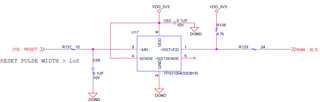

Hi Team,
My customer is using TPS3106K33DBVR. They found that when MR voltage rise above VDD, the device will be locked, and only a power outage will allow the chip to return to normal.
Could you tell me why the MR voltage can't rise above the VDD, is it normal to lock the device when this happened? Thanks.
