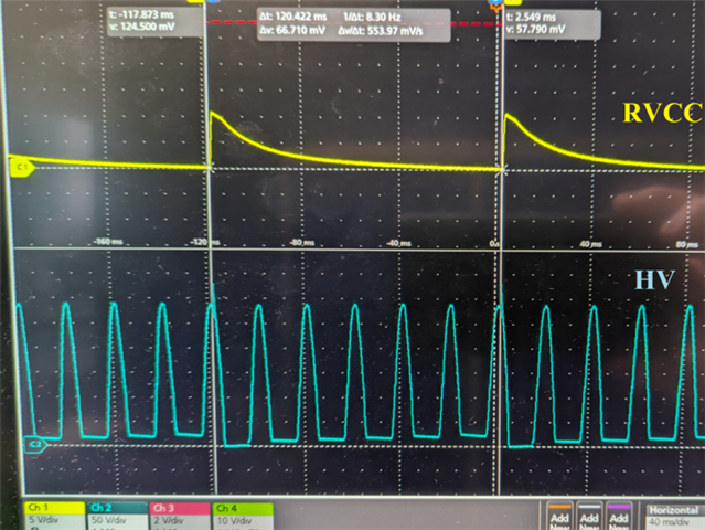

I'm having some issues with this UCC256404 design:

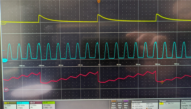

LLC_EN is set to 0 V so the switching is disabled. When the AC is connected (Vin+ and Vin-), these are the waveforms for the HV and RVCC pins:
RVCC reaches around 12 V, but it restarts every 120 ms. And the voltage at the HV pin is a half-wave rectified sine wave.
The flat portion of the HV waveform just after RVCC starts is 0 V, but then it raises every cycle (10 V, 13 V, 16 V, 19 V and 21 V). The dataseet says the zero crossing is detected around 9 V, so that may explain why RVCC resets continuously. However, shouldn't HV be a full-wave recitified sine wave? And why is it not reaching 0 V all the time? Thanks in advance for your help!

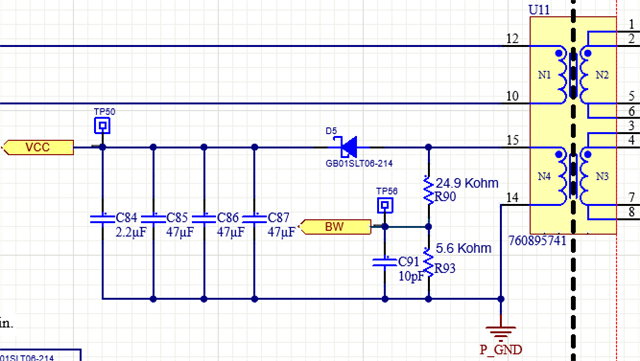

  • Hi Manikanta,
    Sure, this is what is connected to the VCC pin:

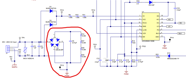

    Thank you for your message. I think I found the issue. I don't have this section (marked in red) in my design:
    I did some simulations and without these components, the voltage at the HV pin is a half-rectified sine wave, but with these components it becomes a full-rectified voltage.
    I'll be able to add these components tomorrow. I'll post the new waveforms as soon as get some results.

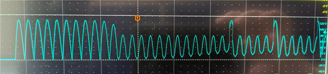

  • Hello! I added a full bridge rectifier like in the schematic shown in my previous post and now I get a full rectified waveform for the HV pin voltage, but just for a few cycles:
    After the initial cycles, the waveform gets distorted with an offset, so I don't think the IC is detecting the zero crossing. This is caused by the controller IC (I removed it and there is not distortion). I tried a second board and I get the same result. I'm still keeping BLK at 0 V, but setting BLK = 2 V doesn't make any difference and the LLC converter doesn't start switching. RVCC and VCC keep resetting way faster than 1 second, so I don't think the IC is detecting a fault. It may not be detecting the mains and forcing the X-capacitors discharge. Any idea what may be causing this? Thank you!

    Your waveform looks like you have some filtering on the HV pin.  When the HV pin stars drawing current it attenuates the sing wave.

    However, I managed to get the LLC started! And when it starts switching, the HV voltage transforms to the nice full-wave rectified sine wave.

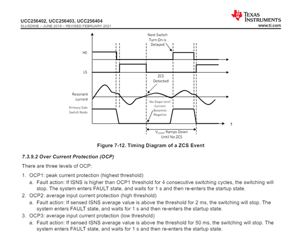

    If you are at full load and the converter is bursting.  More than likely you are hitting an over current protection mode fault reset.
    I would check your ISNS divider to make sure it is setup correctly.  The ISNS resistor might be too large for your design.

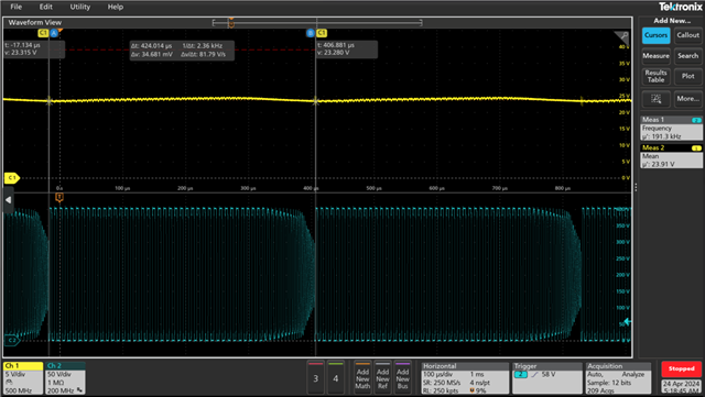

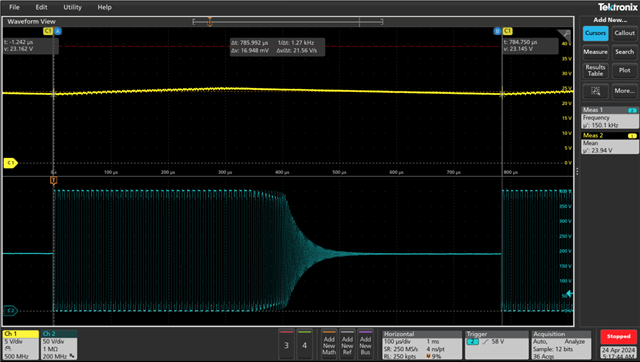

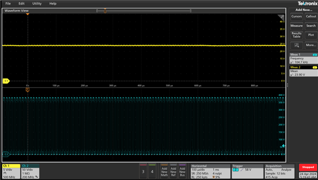

    Thank you for your message. I reviewed the design following the "1440.UCC25640x Design Calculator Rev4.0.xlsx" Excel document, but I still can't figure out why the converter stops switching periodically. These are 2 waveforms that I took this morning. The first one is at 50% load (5.5 A), and the second one is at full load (11 A). The yellow signal is the output voltage (24 V), and the blue one is the drain-source voltage across the bottom MOSFET on the primary side:
    However, I can make it switch continuously if I reduce the input voltage. For example, this is at full load at 375 V input voltage instead of 400 V:
    I'm not sure it's an over current protection, since it happens for small loads too. But I'm not sure if it could be a burst mode issue either.

  • Hi Marcos,
    Looks like the controller is operating in burst mode. You can adjust the VCR caps and/or Burst mode settings to avoid this situation.
    Manikanta P
  • Hi Manikanta,
    You were right, I adjusted the VCR caps and it's working perfectly now. I really appreciate you and Mike's patience. Thanks again for your help!
