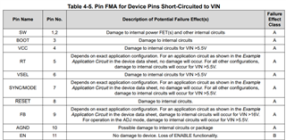

Thank you very much for the document - this is very helpful.
I am curious as to why internal shorts to VIN are not included in the analysis. That seems to be included in the other TI FMEA analysis for potential package failures: pins open, pins shorted to adjacent pins, pins shorted to ground, and pins shorted to VIN. Is there a reason the short to VIN does not need to be considered for this IC?
Thanks!
Hi Jessica,
this are included, see row 11 and 14 - or do you ask for something else?
Stefan
Hello Stefan,
For example, the buck regulator LM63635-Q1 includes a table of short circuits between any pin on the IC and VIN:
This seems pretty consistent for all the TI functional safety analyses.
