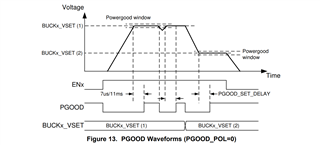

1) Does "PGOOD indication signal" output after all Vout (Vout1-4) is stable?
    Yes,  there is soft indication as well in terms of interrupt which gets set when output voltage reaches to the VSET value.
    Additionally, PGOOD signal at PGOOD pin is hardware indication and it does get active (depending on the polarity set by default) when voltage reaches to its programmed value with delay of 7µs/11ms as shown in Figure 13 in DS.
    In addition to above functionality, PGOOD is also meant to be used for voltage or current monitoring purposes as well. You can read the 7.3.7.1 section of DS for further details.

    If PGOOD is not used you can choose to not select each of the Bucks for PGOOD monitoring in PGx_SEL ( PGOOD_CTRL1 register). This is explained in 7.3.7.1 and also you can refer to the Table 6. in the same section for PGOOD operation information.
