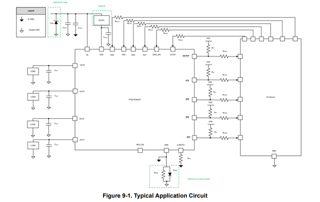

5. When implementing the reverse protection ground, do any pin-to-ground connections attach to the pin 21 chip GND signal or the V- power supply signal?  The TPS274C65CPEVM schematic shows pin pull down resistors connecting to V- and only the PowerPad is connected to pin 21.

    5. The EVM has a lot going on in order to provide functionality and an easy user experience, however from a conceptual point of view I would use the reference schematic in the datasheet:
    Maybe I am missing the question- however are you asking for unused pins (for example if you are not using DIAG_EN), can you tie these directly to ground? The recommendation is to either float the pins (the digital pins have internal pull-downs) or to explicitly pull them down with RPROT. There are ESD cells on the digital pins so any voltage above the recommended/abs max conditions in the datasheet (which would occur in reverse polarity) would potentially bias the ESD cells and cause damage.
