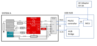

I am considering a circuit with the following configuration.
For SYSTEM A, I am considering TPS25751 as the PD controller.
(Question 1)
Also, I am investigating what kind of device the PD controller should use for the USB HUB.
What kind of device is appropriate to use in a USB HUB?
Can TPS25751 be used?
(Question 2)
If you have any materials that explain the PD control flow (sink/source switching, etc.), please provide them.
(Question 3)
I am considering products from MediaTek and Qualcomm as the processor for SYSTEM A, but is there a possibility that USB PD cannot be realized depending on the processor?
Please let me know if there are any points to be careful about when selecting a processor.
