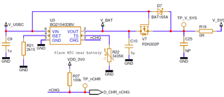

customer is observing a Pre-charge to fast-charge transition threshold of 1.54V instead of the 2.5V claimed in the DS.
The battery was simulated by a H-bridge power supply.
Would you know what could cause this deviation?

Hi Stefan,
Please provide more information to diagnose this issue. Please share a schematic. What is VIN, VOUT, TS, and CHG/ voltage? Please capture a waveform of the previous four waveforms as well.

Hi Michael,
schematic attached as as the waveforms (1c charging at 3.8V battery voltage, 1x without connected battery)

Hi Mike,
In accordance with the circuit diagram, 5V is applied to V_USBC. In the PDF V_BAT_open, nothing is connected to V_BAT; in V_BAT_3.8V, a battery with 3.8V cell voltage is connected to V_BAT. Vin = blue, Vout = red, TS = green and nCHG = yellow.

HI Mike,
For this test, customer used a four-quadrant power supply (Rohde&Schwarz NGM201) as battery and simulate the charging cycle with it. The charging current switches from Iprecharge to Ifastcharge at 1.51V.

Hi Stefan,
Depending on your charge cable resistance and your load, the value at the four-quadrant supply may be different from the actual battery pin. Please measure directly at the VOUT pin.

Hi Mike,
I repeated the measurement today. Nothing changes in the Vin, Vout and TS signals during the changeover (short-term and long-term). I recorded Vin, Vout, and TS during the switch (trigger point). Vout was set from 1.3V to 1.4V to trigger the switch from precharge to FastCharge. I also recorded a log with the charging current over the entire battery voltage range (resolution 100 ms). Here it is clear that the IC switches from PreCharging to FastCharging at 1.4V. Then at 1.7V the IC switches back briefly to PreCharging (this is exited after about 300 ms). It then remains with FastCharging.

Hi Stefan,
I have confirmed on my EVM that LOWV occurs at 2.5 V battery. Can you please try an ABA swap? If you are in 5V input you will have a large dropout to 1.3 V battery which will put the part in thermal regulation. Can you please check your ISET resistor?
