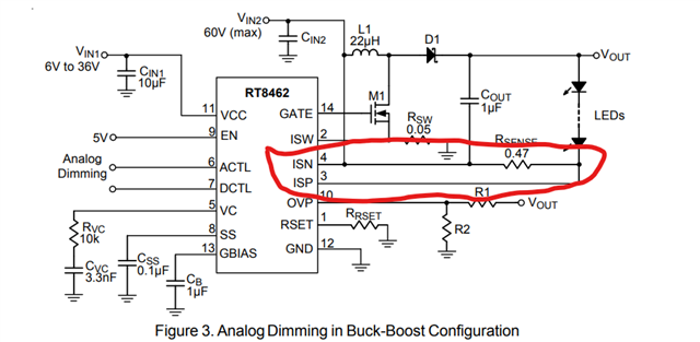

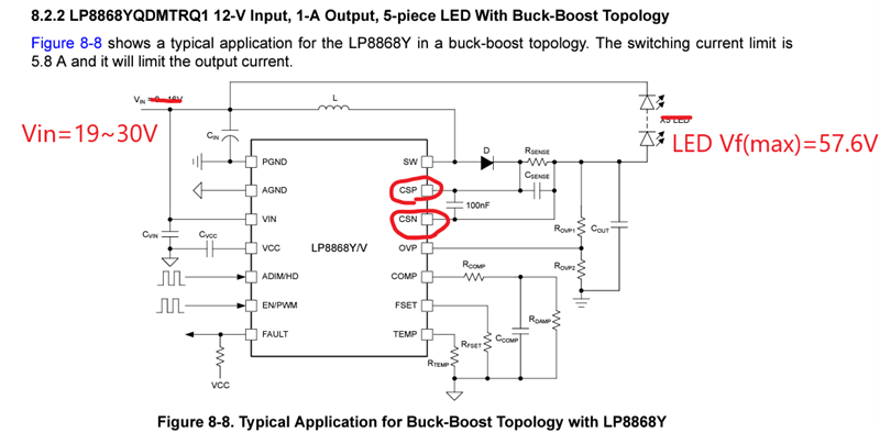

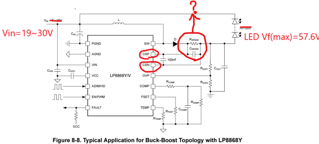

May i check if LP8868Y-Q1 can be used for Vin= 19~30V, LED Vf(max)= 57.6V LED 0.65A application ?
datasheet mentioned CSP,CSN max rating is 63V.
From datasheet reference schematics shown as below, look like the CSP and CSN pin will see Vin + LED Vf(max) = 57.6V+19V = 76.6V voltage. is my understanding correct?
If LP8868Y can not be used in this case, any other suggestion?
