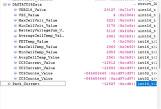

Not getting the accurate current at the time of CC2 Counts reading. The actual current on the clamp meter is 26.3Amp and we are getting from AFE is 13421mA.
Measurement interval time from AFE is 500mSec.
Please help us with what other parameters or settings should we set to get the accurate current.

  • Hi Luis, I tried to read DASTATUS5(), please check the image of all data after the above-suggested configuration.
    In below images Pack_Current is reading of CC2 register and other DASTATUS5(). The actual current was flowing 25 Amp but getting below values.

  • Hello Raja,
    Section 2.9.1 Code Example of the same application guide shows an example code for the calibration procedure. That may be useful to see.
    Ib, Ia are known current values that you would apply. So, if you apply a known current that would be one point, then you can apply the second known current and that would be Ib. While reading Ia you would read the CC_Counts for each current respectively. Then put these in the equation. The CC counts you can get.

  • Hello Raja,
    I would suggest that you use an online calculator for the IEEE-754 to confirm if your code is correctly converting it. I'd also make sure that your checksum and length is being properly done. A logic analyzer capture sequence would help me confirm that for you.
    This older E2E ran on a similar issue:
    https://e2e.ti.com/support/power-management-group/power-management/f/power-management-forum/1346253/bq76952-problems-programming-calibration-current-cc-gain-register
    The checksum in this case was not correct.
    Luis Hernandez Salomon
  • Resolved, I was using the wrong register value at the time of transmitting data. Thanks for the Big support.
