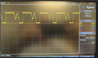

    This 1st  image is of the new POE51Q-24ED primary waveform at the FET driving the primary of the xfmr.
    Seems there is a little "hang/glitch" after the small sinusoidal waveform before the waveform goes to 0.

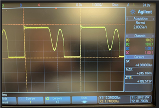

    This 2nd image is of the original POE300F-24L_ primary waveform at the FET driving the primary of the xfmr.
    Ignore the scale, my tech didn't get that adjusted, but you can see the similarity.

    POE40Q-24ED is supposed to be more suitable compared to POE51Q-24ED for your cases considering the inductance of POE40Q-24ED is higher. The flyback converter goes into discontinuous mode when the current drops to 0 A on the secondary rectification. The larger inductance will offer shorter discontinuous mode time and potentially lower RMS current for better efficiency.
    POE300F-24L_: 42 uH
    POE40Q-24ED: 27.8 uH
    POE51Q-24ED: 22.2 uH
    When it goes into oscillation, the leakage inductance of these transformers will take effect.
    Diang

    Sorry for the confusion. I mean the 0-A is when the "secondary current" goes zero as shown in the attached picture, and the flyback converter will go into DCM. Then there will be oscillation on the Vds. The oscillation in DCM normally won't cause issue for the converter. Theoretically POE40Q-24ED could be better than POE51Q-24ED for your power rating for the larger inductance.
