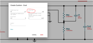

How do I combine ceramic and electrolytic output capacitors in a webench simulation?
    We don't have that capability for this model.
    What I recommend is doing a custom part. Specify the capacity as the total capacitance and ESR the ESR of the electrolytic.
    The ESR of the electrolytic, if large, can impact stability so it would be good to look at.
