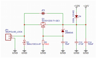

Schematic

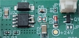

Top copper
Without zone

    Thank you for sharing your schematic and layout. However it looks like there are some missing components from your schematic that are present in your layout (for example CIN is absent from the schematic but present as C14 and C12). Please share with us an updated schematic so that we may better assist you.
    In regards to your layout, I noticed that these planes look unconnected. Is there no topside ground plane connection between the ground plane above the IC and below the IC? There should be a topside ground plane that is directly underneath the IC to connect these two GND planes.
    It would also help to move C14 in such a way where C12 can be rotated to connect to the IC's ground plane as opposed to through VIAs. This would aid in minimizing the loop created by the bypass capacitors, the VIN pin, and the TPS543x ground pin. Please see section 7.4.1 of the datasheet for more details.

  • Hi Joshua and thanks for your rapid answer.
    Here is the 24V schematic. This board will work at a battery level.
    CAD software was with 3D component enabled. Sorry for that misinformation. Here is another picture. Yes, it has zone on top copper applied.
    As to rotate the C14 capacitor. You mean this:
    Unfortunately the problem remains. You have another tips with the new information I gave to you?
