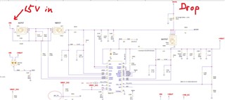

We are using Bq24172 as our charger.

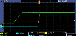

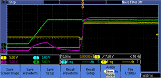

We noticed that when VBAT < 5.8V, and we plug adaptor (15V)  for charging, we saw Vsys will drop from 5.8V to 5.0V, then pull up to adaptor voltage 15V.
Is there any possibile reason for this voltage dropping?
CH1(Yellow): VSYS
CH2(Blue): Gate of Q18
CH4(Green): VIN
