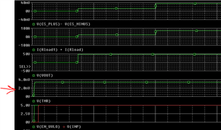

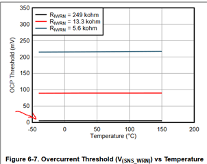

Hi guys,
can someone at TI confirm if the overcurrent protection is modeled in the TPS48110 pspice model?
It appears that only the short circuit protection is modeled.
Even with RIWRN at >= 250K, impossible to start the VTMR charging, but the CS voltage should trigger it.
