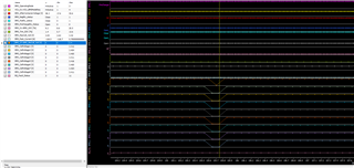

Once in a while we are getting cell balancing voltage dips on 1st 8 cell voltages connected in series once in a while during Charging or discharging. As shown in Pic-1.
Hi Veto,
I'll take a look at this. Are you able to monitor the voltage dips on an oscilloscope as well or provide some data that shows the voltage dip?

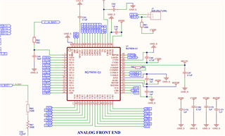

Dear Anthony,
I have some Dilemma in the following points
1. As we have used transformer Isolation between both the Grounds (MCU & AFE's), do we still require any digital Isolator ?
2. Are you suggesting the digital Isolator ISO7342CQDWRQ1 between both the grounds ?
3. If we use a digital Isolator like the above, exactly where to use them, I guess after the Bridge IC BQ79600 ?

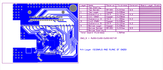

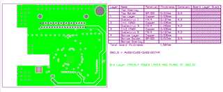

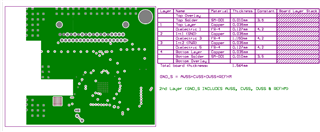

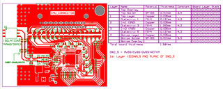

I am attaching our Circuit diagram for your reference
Please let me know If you have any doubts regarding the queries as well as the schematics
Let me spend some time with the schematics and let oyu know.
Anthony Pham
Apologies for the delay. My comment regarding separate GNDs was between the MCU GND and the AFE ground but as it was problems on the VIF communication, the capacitor looks to be a good solution.
Layout looks good.
