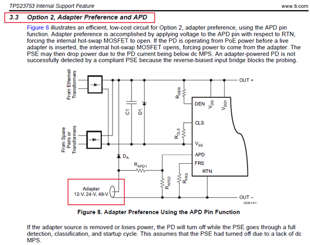

The customer is reviewing the TPS23754PWPR for the RFID reader model and has technical inquiries.
The customer wants to ORing the POE power and the 24V adapter DC power to create a 12V output for operation.
The attached photo refers to the Oring section of (Application note)_Advanced Adapter ORing Solutions using the TPS23753 (www.ti.com/.../slva306a.pdf

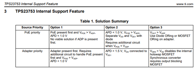

I would like to apply Adapter Priority to Option 2 among Oring Options.

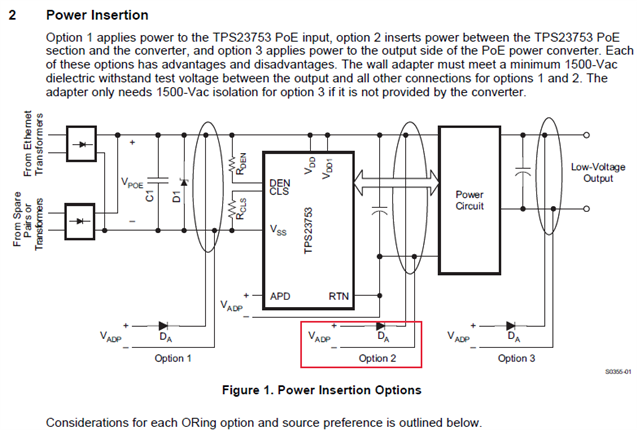

(Questions)
In photo number 2, the insert power location of Option2 Adapter is located at the TPS23753 PoE and Power Circuit.

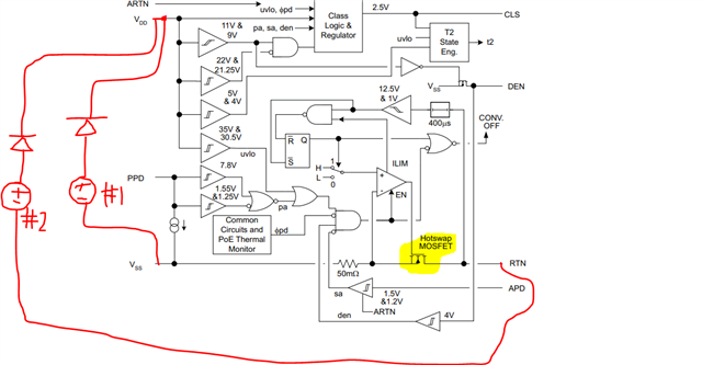

In photo 3, the insert power location of Option2 Adapter is located before TPS23753 PoE.
Can you confirm where the Adapter Insert Power is located?
Please check. Thank you.
