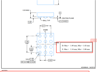

The package size of this product we tested is not consistent with the datasheet. The datasheet is 1.49, but our measurement is 1.512
Could you please help to confirm why such an anomaly occurs? Is there a tolerance range

Hi Yingjiao,
Firstly, you should make sure your measurement is 100% correct. right?

Hi Yingjiao,
I double check with our PE team, and i am afraid you are correct.
The size in DS is not correct and the actual size should be 1500±20um

Hi Yingjiao,
I am afraid they are internal only, but we will modify the mistake in DS in further. Then you can see the correct size info from DS.
Thanks for your kindly remind.
