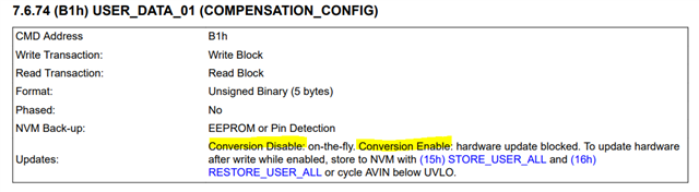

  • Hi Karthik,
    In general, we want to make sure the output is turned off during configuration. I recommended 3.3V because, at 3.3V, the PMBus will be active, but the output voltage conversion is disabled. However, other ways to turn off conversion include bringing the EN/UVLO pin below its UVLO threshold.
    Does this mean the converted voltage or while converting the voltage, the PMBUS pin will not be active?
    PMBus will be active if the input supply (or AVIN) is above its UVLO (2.5 V typical), regardless of whether the converter output is turned on or off.
    However, not all registers allow On-The-Fly updates; some PMBus configurations will be blocked if Conversion is Enabled. That is why we don't recommend configuration when the converter is enabled. Here is an example:

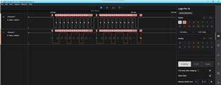

    Here is a snip from logic analyzer for the detection of slave address in TPS546A24 IC
    M Karthik
  • Hi Karthik,
    I spoke with a team and it turns out that the issue you are experiencing is a known bug in the TPS546x24y series of parts. When the device receives its address plus the read bit, it NACKs instead of ACKing and reporting a CML warning as per the PMBus specification.
    To resolve this issue, please ensure that you are using the correct read protocol. The TPS54624A does not respond to direct read transactions with a 7-bit address plus the read bit (as you have in your snip). Instead, it requires all transactions to start with the 7-bit address followed by a write bit and then command code.

  • Hi Tomoya,
    Please enlighten on what the correct read protocol here is according to the one we are using, i.e. using ' i2cdetect -y -r <i2cbus> ' command.
    Also, as you mentioned,
    1. Is the CML warning present in the snip that i provided earlier?
    2. What is the transactions that is required here, and how to proceed with initiating these transactions within the terminal, does this mean before carrying i2cdetect command, there is requirement for executing any other commands?
    M Karthik

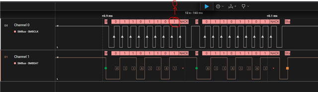

  • Hi Karthik,
    What you need to do is change the bit circled in RED to 0. This should fix your problem.
    Thank you,
    Tomoya
  • Hi Tomoya,
    The circled bit is of clock signal,
    1) Do I need to make a clock signal 0 or the data signal?
    2) Also, I used the command ' i2cget -y 7 0x24 w ' to penetrate directly to the slave to read out but it failed.
    3) For the above solution, can I use 'i2cset -y 7 0x24 0x ...A....  0x ...B... ' Here I am unsure what should be A and what should be value of B (0x00 assuming to what you have suggested above)
    M Karthik

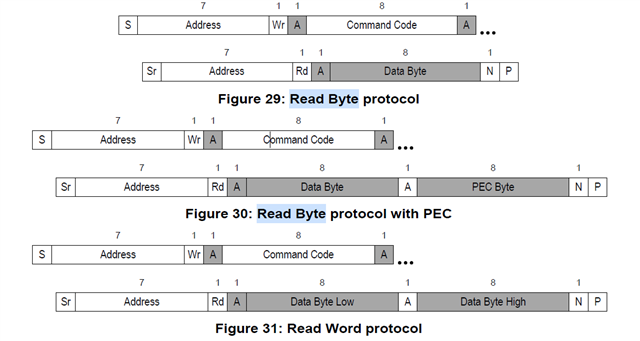

  • Hi Karthik,
    It is the data signal that you need to change, not the clock signal. The clock signal should be 1, 0, 1, 0, 1, 0, etc.
    Please refer to the SMBus spec for the Read protocol:
    If you have any further question, please reach out to me directly at t-ide@ti.com.
