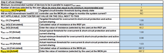

My customer application is 12V and 54A continuous load current.
1. is it real Itrip? or it's Iocp.
I have calculated it by below equation
I think the result is Iocp rather than I trip. I trip should be 2x Iocp.
2. if my customer I out is 54A. How much ILIM do you recommend?
Thanks for your help Slight smile
