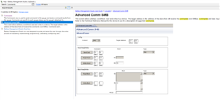

I am trying to perform OTP programming but noticed BQstudio is missing subcommands:
OTP_WR_CHECK() (Subcommand 0x00A0)
OTP_WRITE() subcommand (0x00A1)
I am using BQstudio version 1.3.124. Is there anyway to add these subcommands to the "Commands" window? I read through the help file and it mentioned:
The commands shown in this view are configurable using the commands.xml in the bqz.Commands
I cannot find this file and am not sure how to do this.
The other thing it mentions is Advanced Comm SMB below. But I cannot find this tool in my version of BQstudio. There is "Command Sequence" but I am unsure how to use this to send subcommands. If this is possible could you give me an example on how to send OTP_WR_CHECK() or OTP_WRITE()? My BQ76952 is at the default address setting of 0x10.
