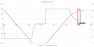

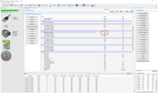

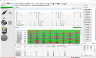

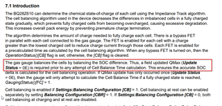

I have a basic set up right now, with a 2S battery connected to 2P, 1P and 1N of the gauge. I also have a power supply connected to Pack+ and Pack- on the gauge.
I want to do a basic charge test, where I am charging to the float voltage 8.9V, at a current limit of 1A.
However, during the charge, it may be working for a few minutes, but then charging current will be 0. Pack+ and Pack- (Power supply connected) will show 8.9V, but 2P, 1P and 1N will show a much lower voltage, like 7.4V. The battery won't be charging at this point, and when I refresh the BQ Studios page, the chg fet is now disabled. Toggling the fet doesn't fix the charging. Here is a basic log of voltage and current to show this:

I tried again with a fresh gauge EVK and a different battery and a different PC, but I still see the same result.
Here are the gas gauging files for both batteries I tried this on. Standalone2.gg.csvStandalone.gg.csv
Is there a setting that is preventing it from charging properly? What is causing the chg fet to become disabled?

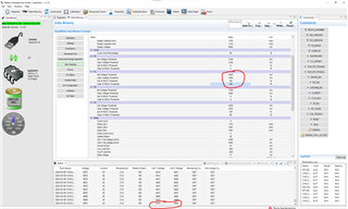

  • Hello Kelvin,
    Thank you for providing me with this. I have taken a look at this and it appears that the two cells are very imbalanced. What is happening here is that when the charging starts, the voltage of cell 2 increases to a value above the COV threshold. This then trips the COV protection and prohibits charging.
    Essentially what is happening here is that one of the cell voltages surpasses the COV protection threshold, then the COV protection gets tripped and turns off the CHG FET.
    Jonny.

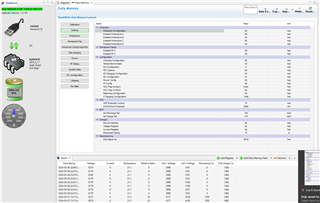

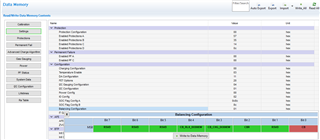

  • Thanks for the response Jonny,
    How can they be so imbalanced if I have the CB bit enabled on the gauge? Wouldnt this allow the cells to be balanced before one of them gets to COV?
    I have the default balancing settings still, where it looks like it should balance once the delta between the cells is 3mV or more:

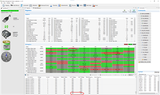

  • Hi Jonny,
    Another point to my previous comment:
    I checked the voltage from 2P to 1P = 3.634V

    Another issue seems to be that the BQ28Z610 isn't balancing the battery. But it should be balancing with any delta above 3mV. Are my settings in my previous comment for balancing correct?
    Kelvin
  • Hello Kelvin,
    Are the voltages you are measuring the voltage at the pack pins or the voltage at the IC pins? How was the gauge calibrated as well, because there is a disconnect between the actual voltage of the cells and the voltage that the gauge is reading. Additionally, It looks like a learning cycle was not successfully completed. This must be completed in order for cell balancing. Please see the image below.
    I recommend referring to the BQ28Z610 TRM as this document goes over the cell balancing feature in detail, and goes over what all needs to be configured.

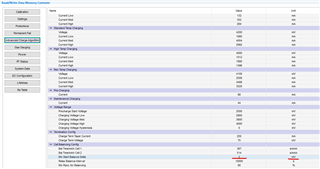

    You can see cell 1 and cell 2 are way off. This is with me disabling balancing, because they are already balanced and I don't want it to be interfered with. However something weird is happening when the battery is attached to the fuel gauge. How can I make sure the gauge isn't doing any balancing? I have disabled both of these bits here:
    Is there anything else I need to do to prevent the gauge from balancing the cells?
  • Sorry Jonny, I actually realized my problem, which was a loose solder connection on the midpoint of the battery. I still want to make sure balancing is disabled though. Is it correct here to disable all balancing?
    Kelvin
  • Hello Kelvin,
    Glad to hear that you have resolved your issue. To disable cell balancing, you just need to set Settings: Balancing Configuration [CB] = 0. Please see the following screenshot taken from the TRM where this is stated.
    Jonny.

    Thanks for that. So I went back to the battery that we performed a learning cycle for. The chemistry is programmed. I filled in the design capacity and charge voltage. I started from a balanced state and began charging. However, the TI gauge increases the SoC steadily and then suddenly jumps from 30% to 100% SoC.
    Why is the state of charge so inaccurate? I believe I have all the settings correct in the gas gauging tab: K_Standalone.gg.csv
    Here is my log of this. It is a basic setup with the standalone battery connected to the gauge, and a power supply connected that is charging to a target voltage of 8.9V with a 1A compliance. K_Standalone_Charge.log
    From what I can tell, the values look correct except for the relative state of charge, where you'll see it suddenly jump from 30% to 100%
    Kelvin

    The problem with trying to perform the learning cycle is that it keeps stopping during the charge phase. This is because of what you talked about earlier, where the chg fet is becoming disabled, probably because of a lack of balancing.
    I have balancing enabled and here are the balancing settings:
    Log of the charge procedure during learning cycle. I have target voltage on my power supply to 8.9V, and 1A current limit
    LearningCycle_StoppedFromChgFet.log
    I want to complete the learning cycle. How can I fix this so that I can proceed with it?
    I think before we thought that the chgfet was being disabled because one of the cells reached over voltage from lack of balancing, but according to this log, both of the cells are well within the correct voltage range (~4.2V). However, it does seem like it's not balancing because the delta is about 40mV.
    Kelvin

    Were the only values you have changed here are the design capacity and charge voltage? In order to successfully complete the learning cycle, you need to change more parameters than just these two. Please refer to the Achieving The Successful Learning Cycle document and follow the steps there.
    Jonny.
  • Hi Jonny,
    No, I changed all of the values that are listed in that document:
    Design Capacity: 1703mAh
    Charge Term Taper Current: 70mA (recommendation from doc)
    Dsg Current Threshold:10mA (recommendation from doc)
    Chg Current Threshold: 10mA (recommendation from doc)
    Quit current: 5mA (must be lower than dsg and chg current threshold
    Term Voltage: 6200mV (Battery will discharge down to 3.1V
    With all of these settings set I still see that the charging consistently stops at about 80% and chg fet becomes disabled

    The FC bit is a Flag that gets set based on the thresholds you have configured. Please see the device TRM for the FC flag threshold.
    Have you tried to manually control the FETs to complete the learning cycle?
    Jonny.
  • Hi Jonny,
    Yes I have set the FC thresholds from the beginning, where it should reach it at 4.45V (2S charge voltage is 8.9V).
    The problem is that the chg fet becomes disabled before reaching this threshold even with the protections all off.
    What do you mean manually control the FETs? I try to enable the chg fet again to continue charging, but it won't work. The only way to enable it again is to discharge the battery a bit, and then begin charging again. But even if you do this, it'll become disabled again after charging for a while
    However in my run that I'm doing now, I decreased the charge term taper current to 25mA, and I see that one battery has reached 4463mV, so this is already above the 4450mV threshold for FC. However, the other cell is at 4408mV. The chg fet has become disabled now and there is no current on the battery (it's not charging anymore). But the FC bit is still not high, so it won't move onto the next step of the learning cycle
    I have balancing enabled. But it seems like the cells won't balance and still have this ~55mV delta. From my understanding, balancing doesn't work until the learning cycle is completed and the update status is 0x0E. But it seems like I need balancing to complete the learning cycle. So I'm stuck in this loop and can't get out of it.
    My update status is still 0x05, and I need to charge, relax, discharge, relax for it to complete.
    Kelvin
  • I also tried this experiment where I changed the FC threshold to 4400mV instead of 4450 to really make sure we reach it. Both cells reached it here:
    But the FC bit is still low. Soon after this, charging will stop because the chg fet becomes disabled and FC bit is still low. However during this charge cycle, I did change the FCSETV bit to high. Does this bit have to be set beforehand? Or is there a way to "reset" the learning cycle so that this new FCSETV bit will work to get the FC bit to be high?
    Kelvin
  • Hello Kelvin,

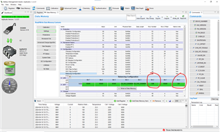

    You can manually control the CHG and DSG FETs by the 0x001F and 0x0020 Commands (see image below from the TRM).
    To be able to toggle the FETs, you must have FET_EN = 0.
    Jonny.
  • Hi Jonny,
    Thanks for the info. I've used this method to try and get the FC bit to go high for the learning cycle, but I still can't get it to happen.
    So I changed the FC threshold to be lower to ensure that the cells get to that voltage. Then I discharged, relaxed, and then charged. However, the FC bit still wasn't high even though both cells were above the threshold. As usual, the chg fet became disabled near the end of charge as well. So I then disabled FET_EN, and then toggled CHG and DSG FETs to get it to charge again, hoping to reach the FC bit. It charged for a bit afterward, but still no FC bit.
    Please see my settings. The FC threshold is 4350mV, both cells are above 4400mV, but the FC bit is still low, so I can't proceed with the learning cycle.
    I'm really trying to understand what I'm doing wrong here to not be able to complete this learning cycle
    Kelvin

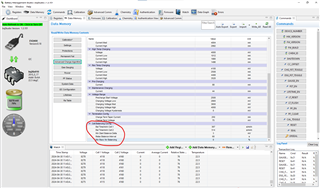

    After it discharged this morning and had several hours to relax, I see that the update status has changed to 0x0E. So now the learning cycle is complete and cell balancing is enabled. My last question is about the golden image. In the docs, it says to generate the golden image after the learning cycle. Now I do remember doing this with my 1S gauge where it showed up in the BQ studio GUI, but I don't see the option for the golden image for this 2S gauge:
    Is there another way to save this learning cycle? In addition I also saved the gas gauging file. I want to make sure that everything is saved because it took a long time for me to successfully complete the learning cycle Slight smile
    Kelvin
  • Hey Kelvin,
    To create the golden image, you can use the "Golden Image" tab in bqStudio (see image below).
    Jonny.

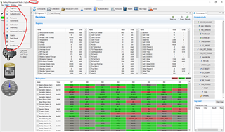

  • Hi Jonny,
    There is no golden image tab in my BQ studio GUI. I used the golden image tab before for the 1S gauge, but with this 2S gauge, there is no golden image tab
    Kelvin
  • Sorry, forgot to add my screenshot in the last message:

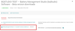

  • Hello Kelvin,
    Please use the latest version of bqStudio (this is the TEST version) on the bqStudio webpage.
    Jonny.
  • Hi Jonny, thank you for the info. I have downloaded the latest version that you showed there, 1.3.124, but there is still no golden image tab in BQ studio:
    Kelvin
  • Hello Kelvin,
    Please update the FW to the latest FW on ti.com for the BQ28Z610. I have just tried this on my device and there is the "Golden Image" tab.
    Jonny.
  • Hi Jonny,
    Thanks a lot for the info. I update FW and was able to save the golden image. Today I did a discharge/charge test and plotted Current, Voltage and RSoC. I noticed that at the end of charge, the RSoC suddenly jumps from 96% to 100% instantly:

    Please refer to the following image for setting the charge term taper current to 10% higher than the charger taper rate.
    Additionally, if the valid charge termination conditions are met, then the gauge will report SOC of 100%. The SOC can jump from the 96% to 100% as you are experiencing if the valid charge termination thresholds are incorrectly configured.
    Jonny.
  • Thanks so much Jonny,
    I ended up keeping the same charge term taper current at 300mA, and instead changing the ChargingVoltage setting to 8900mV (our float voltage). Charge_New.log
    Attached is a basic charge cycle. It did seem to fix the issue where the SoC jumps from 96% to 100%, and now it reaches it smoothly.
    1. However, It reaches 100% when charging current is about 100mA. Shouldn't it still be when current = charge term taper current at 300mA?
    The valid charge termination conditions are:
    A. Current is below charge term taper current
    B. Max voltage of either of the cells is higher than the charging voltage setting divided by 2 (one cell has to be 4.5V or higher)
    C. Accumulated change in capacity has to be greater than 0.25mAh
    B and C are reached early because the cell reaches constant voltage charging early, and the gauge is learning during the charge cycle so the capacity change will be there. So that leaves A as the final condition, but it seems like it still happens after A. Is this correct?
    2. There also seems to be a "hold" at 0% SoC, where it takes almost 3.5 minutes of charging to go from 0% SoC to 1% SoC. After that, the SoC increases normally and much quicker. Voltage increases from 3.1V to 3.8V in the time it takes to go from 0% to 1%. Why does it take so long to go from 0% to 1%? Is there a hold setting that I have configured wrong? I have the FD clear threshold at 3.1V, so this shouldn't be affecting it. 2S_GG.gg.csv
    3. Would there be any issues with performance if I were to use this gauge at cold temperature? So far, everything has been done at room temperature (The data collection for the chemistry programming, the learning cycle, and each charge cycle so far has been at room). For testing at cold, would there be any additional preparation I would have to do for the gauge to perform properly?
    Kelvin
