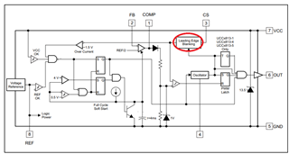

Hello. Datasheet has parameters for "Current sense"(page 6). Which element on the Block diagram (page 9) do these parameters refer to?

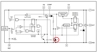

Thanks for the quick response. Number 1) is still unclear. In the other answers you have highlighted some components in the diagram, but in this answer you have not indicated any components. I suspect that this parameter is related to the resistive divider coefficient, as shown in Figure 25. Please correct me if I'm wrong. Thank. Lev
1) The gain is the ratio of COMP pin voltage increase over CS pin voltage increase
For example, when delta_Vcs = 0.8V, A = 1.65V then delta_Vcomp = A x delta_Vcs = 1.65 x 0.8V = 1.32V, typically.
On the others, for example, 2) means that zener diode in red circled is for this specs with min typ and max.
I am not sure which one you do not understand - each red circled is based on the corresponding specs table row.
