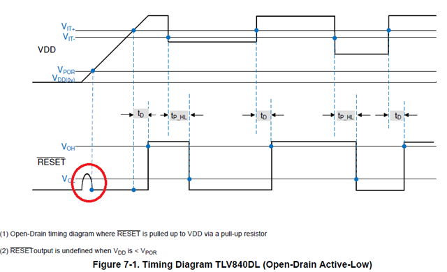

TLV840: Is CT available to avoid the glitch when VDD<POR?
Part Number: TLV840
Hi, TLV840 support team
TLV840CADL29 has a feature programming Reset Time Delay by an external capacitor.
I would like to know if it is available to avoid a glitch at following two case when VDD<POR.
  1. When /RESET is pulled up to VDD
  2. When /RESET is pulled up to other power supply , but it is applied before VCC is powered
