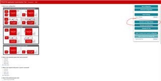

  • Hi Thinh,
    Unfortunately we do not directly support the Linux Drivers as they are not developed by TI, so I may not be able to support you with driver specific questions.
    In regards to "the firmware file", we have an online GUI that is available through the product page.
    The GUI can be used to answer a questionnaire about the system, and then generate a binary or .C file that needs to be loaded the the TPS25750 on boot. This can either be done by loading the full flash binary to an I2C Flash that is attached to the I2Cc lines of the TPS25750, or by providing the .C file to an MCU to load over I2C.
    Thanks and Regards,
    Chris
  • Hi Chris,
    I succeeded in using the above method to create a firmware file for the driver. The log in the driver shows this:
    [ 7.323612] tps6598x 1-0021: GPIO lookup for consumer reset
    [ 7.323630] tps6598x 1-0021: using device tree for GPIO lookup
    [ 7.323681] tps6598x 1-0021: using lookup tables for GPIO lookup
    [ 7.323686] tps6598x 1-0021: No GPIO consumer reset found
    [ 9.474426] tps6598x 1-0021: controller switched to "APP" mode
    But I encountered another problem: when successfully loading the bin file created by the tool "TPS25750 Application Customization Tool", the system was reset due to power failure. I only powered the board via USB type C using a 20W power supply and noticed the power LED blinking abnormally. When the LED flashes once, the whole system is rebooted. it only happens when the bin file is successfully loaded.
    I also attached my setting that exported by "TPS25750 Application Customization Tool", Please help to check if any incorrect answer in the questionnaire
    https://drive.google.com/file/d/1QcXwFkE_TcF0HqMPtJHCc0tBerFTImMr/view?usp=drive_link
    Or tell me how the array in the bin file is organized so I can check it myself.
