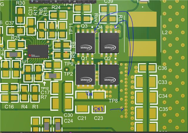

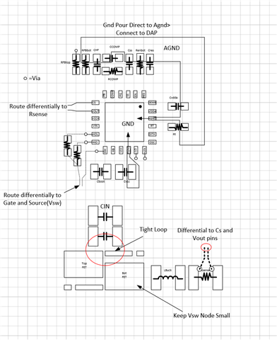

  • Hello Sanjana,
    It's very difficult to get a layout that is adequate when using a controller.  the thing that jumps out to me on your layout is the loop you have formed from the input capacitors and the MOSFETs.  the area between these components is large and as a result you have a large parasitic inductance in sees with your fast DI/DT loop.
    you need to have a tight loop, if you are going to employ the CIN positioning you have implemented, you need to have a solid ground plane under the MOSFETs.
    See an example of an ideal layout below - this is just an example, with a similar device to the LM5148,
     Alternatively, please refer to the layout guidelines in the datasheet and also refer to the LM25149 (very similar device to the LM5148) EVM layout as a reference.
    https://www.ti.com/lit/ug/snvu820/snvu820.pdf?ts=1713812831399&ref_url=https%253A%252F%252Fwww.ti.com%252Ftool%252FLM5149-Q1EVM-400
    Hope this helps.
    David.

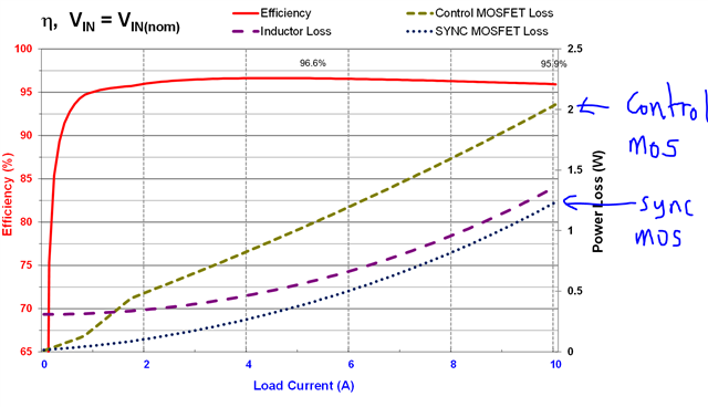

  • Hello Sanjana,
    See below losses for the HS/LS FET you have mentioned in your response above.
    Please see the calculations based on the MOSFET parameters in the attached.
    Forum_mar5_design_calcs dsb edits MOSFET parameters added.xlsm
    Please see application note below for more details on the calculations.
    MOSFET power losses and how they affect power-supply efficiency (ti.com)
    hope this helps.
    David.
