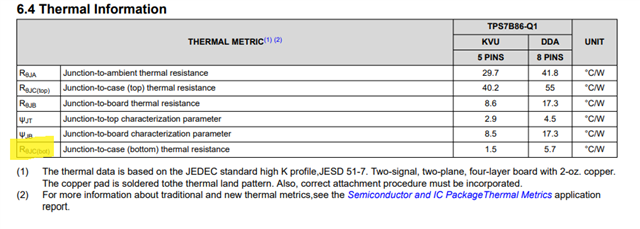

TPS7B86-Q1: thermal calculation depending on copper thinkness
Part Number: TPS7B86-Q1
Team,
can you please advise how to estimate the degradation of Theta Jc with the copper thickness?

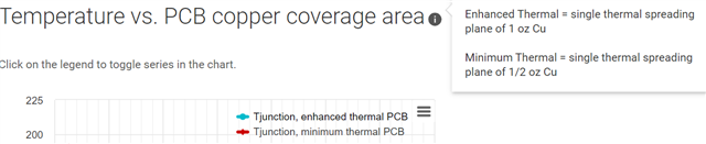

I saw this tool, but it doesnt feature the TPS7B86 and I dont know wath copper thickness is being used.
also for this device what is the realistic Theta Jc you would get ?
https://www.ti.com/design-resources/design-tools-simulation/models-simulators/pcb-thermal-calculator.html?keyMatch=thermal%20simulation
thanks
