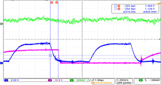

    The time you are talking about is TPW and this time is typically 2.5 us.
    Check the waveform below.
    OUTB is inverted within 2.5us from the falling edge of SYNC.
    Isn't 2.5us the SYNC pulse width when used in master mode?
    CH1:SYNC CH3:OUTB
    Also, there is only one answer for three questions. Please answer the remaining two questions as well.
    You are measuring it incorrectly.  You should measure rising to edge to trailing edge of the sync pulse.
    From your plot it looks to be 2.5 us.
    What period are you talking about? Please illustrate clearly.
    Isn't it correct to understand that the CLK signal is generated after the fall of the SYNC signal, and that OUTA and B are inverted according to the fall of the CLK signal?
    As I have said many times, please answer Q2 and Q3.
    After rereading this I thought the device was operating in the master configuration.  I was referring to the period of the sync signal (TPW) of being roughly 2.5 us from your waveforms.  My mistake.
    Please see the answers to your questions below.

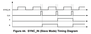

    Q1.What is the time from the falling edge of SYNC to the falling edge of CLK.
    > This sync signal is supposed to provide a 90 degree phase shift when used correctly.
    > To do this the CLK actually will be a 45 degree pulse.
    > So the CLK period should be (45/180)*(1/fsw)
    Q2.What is the falling threshold of SYNC to output CLK?
    >I reviewed the data sheet and it is not given.  However, the SYNC comparator uses CMOS logic levels.
    Q3.Please tell me what happens when SYNC falls when the CLK pulse is high.
    >Please refer to figure 44 of the data sheet.
    Thank you for answering.
    Regarding Q3, what I wanted to know is which of the following two patterns would happen.
    Best regards.
    It actually syncs the clock it is not ignored.  The time should be what is required based on the frequency and what is required to generate the phase shift.
