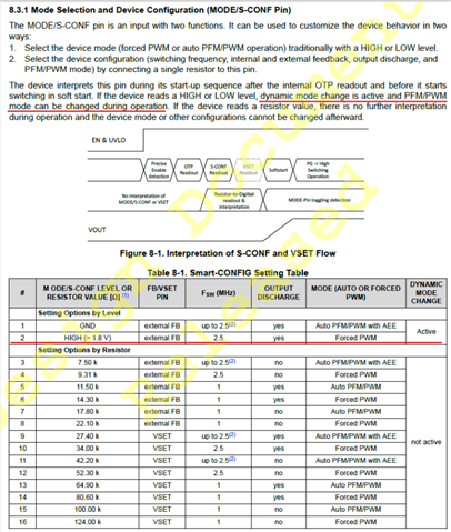

The mode will be Forced PWM if I tied the MODE/S-CONF to high, but in the meantime, the DYNAMIC MODE CHANGE is Active. I'm confused as to whether my configuration is Forced PWM or switching frequency changeable?

Hello Sir,
If mode pin set to high, it is FPWM mode.
Dynamic mode means the FPWM and Auto PFM with AEE can switch with each other automatically during operation with the voltage level change on MODE pin.
