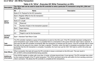

    In general, there should not be a need to do further control as the necessary control is driven from the PD controller. Just to clarify, if your system requires further control of the battery charger, the MCU would need to write to the battery charger through the PD controller using a 4CC command 'I2Cw' (see below from TPS25751 Technical Reference Manual). The team is working on an application note detailing how to utilize this command and will be released in the near future. In the meantime, feel free to reach out with any questions/concerns!
