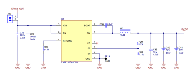

I'm expecting to have 15V on the output on the LMR38020 but I'm seeing the following output where the voltage is around 2V.
Any insight on what may be the issue? Thank you.

The reference design with the setup can be found here https://www.ti.com/tool/TIDA-010950. The yellow line shows the VIN voltage, we are inputting 20V and expecting 15V out
The resistor is the correct value, I think we may be shelving the issue for now. We found a possible contributing factor due to the power planes being split on the PCB that we are looking into.
