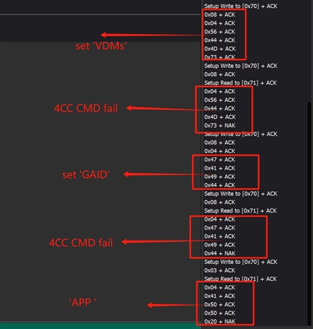

        2.send again 4CC 'VDMs'  Fail:
            a.read 0x03(mode): 0x03 0x04 0x41 0x50 0x50 0x20---'APP '
            b.write 0x09(data1):0x09 0x09 0x02 0xFB 0x01 0x76 0x2B 0x01 0x7D 0x00 0x00
            c.write 0x08(cmd1):0x08 0x04 0x56 0x44 0x4D 0x73---SET 'VDMs'
            d.delay 30ms
            e.read 0x08(cmd1):0x08 0x04 0x56 0x44 0x4D 0x73---'VDMs' 4CC cmd fail
            f.write 0x08(cmd1):0x08 0x04 0x47 0x41 0x49 0x44---SET 'GAID'
            g.delay 30ms
            h.read 0x08(cmd1):0x08 0x04 0x47 0x41 0x49 0x44---'GAID4CC cmd fail
            i.read 0x03(mode): 0x03 0x04 0x41 0x50 0x50 0x20---'APP '

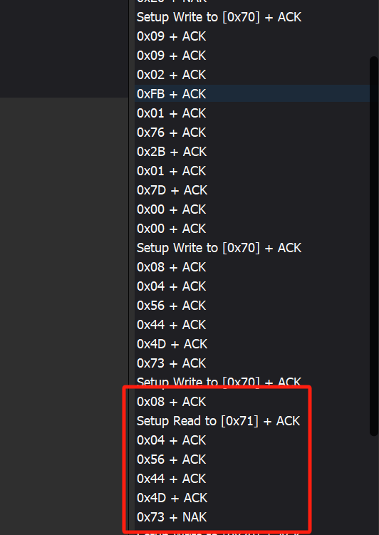

  • At present, from the IIC log, after 4CC cmd fail, try to read other registers of PD (0x03, 0x34, 0x06), the data returns normal, write 0x28 can reset PD,

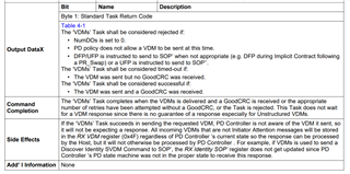

    Could you please help identify where the EC is sending the 4CC command in the PD logs? Is the "Not Supported" message below the point of failure?
    Also, see below for reasons as to why the command could be rejected:

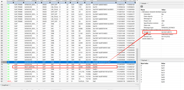

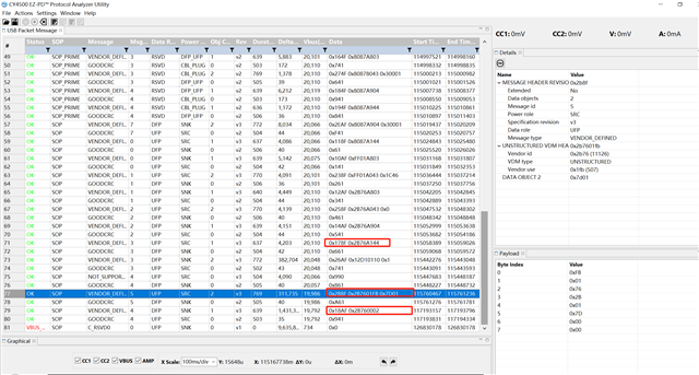

    Unsupported Old vendor id(0x12d1) is not supported, this does not trigger enter mode, so it is normal,
    As shown in the figure, enter mode has been triggered for vendor id(0x2B76), and the first time we send UVDM(0x2b7601fb 0x7d01) is successful,
    But when we receive UVDM(0x2b760002) sent by the object, then our MCU will send UVDM(0x2b76) to write PD 0x09data via IC2, PD does not have any CC log printed out.
    The IIC operates as follows:
    At this time, the PD status register 0x08 is read, and it is found that the execution is not according to spec.
